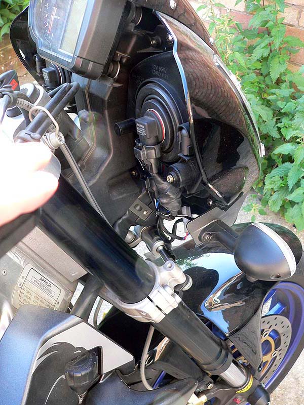

First cable clip on . Fed both positives into same clip for neatness and ease of wiring .
Both clips installed and wired
Final install and covered in self amalgamating tape

Install was easy enough although the blue cable clips dont always splice the Led cables so worth checking or better still solder etc .
Will try and get some more distance shots and see what the guys down the club think but i think there great and will be better with a more white light in my main headlight .

I think your 2nd person to have trouble with 3rd party splice connectors, what might help if others are using them is to double over the Bullet wires to 'thicken' up the connection.
Good idea with the self amalg tape, it's amazing stuff!!
Cheers
Snaggle
Well those dam little blue things are a pain to use at the best of times ..i tried doubling up and it just cut the cables . Eventually i just stripped the ends tinned them and jammed them in the slot as had tried 3 times to do it as it should be done with no success .
Its a bit more tricky on the Tuono as its all open so whatever you do it has to be quite neat . So soldering would probably have been best .
