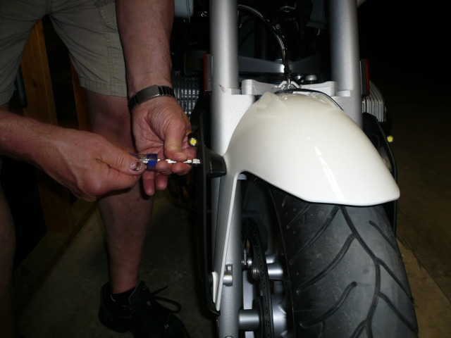

Now here was the mentally challenging part. First I removed the two wind   deflectors for easier accessibility. Then I consumed one Fat Tire amber ale to   get my courage up to drill two 7/32" holes through the wind deflectors. The   holes are for routing the wire. My overall objective was for the installation to   be more or less invisible, so all the wires and posi-tap connectors are   concealed on the finished product. Here's my dad modeling the new Dremel tool   used for the procedure, and the finished result:

At the apex of the fender just beneath the fork mount there's a small pocket   that is where I used the first two of my posi-tap connectors to connect the left   bullet LED to the right one. This was by far the most difficult part of the   procedure. I had removed a good 18" of wire off the left bullet LED so that I   wouldn't have a lot of leftover wire to tuck away somewhere on the bike. The   posi-taps were just a skosh too big to slip through the gap between the top of   the fender and the fork brace, so I had to do all the posi-tapping underneath   the fork brace. It was a pain in the butt, but the posi-taps give a very solid   connection and once the threads of the posi-taps bit, they stayed and the wiring   was very well secured. I supposed I could have removed the front brakes, then   the wheel, then the fender and done it perfectly, but that's a bit beyond my   level of expertise and there wasn't enough Fat Tire in the house to make me that   brave, so I went this route.
I then secured the wires that ran from each bullet LED to the post that houses   the fender screws underneath the fender using zip ties. This served to really snug up the loose wiring and 'suck' he posi-taps under the fork brace. The whole   wiring assembly pretty much disappeared.
