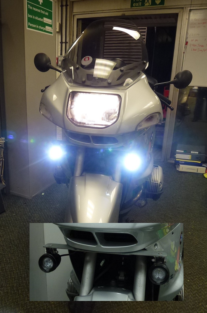

Ted sent this photo of his big R1150RS with Cree v3 lights fitted, saying this...
"Dear Bikevis
Thanks very much for the Cree V3 running lights. They are really well made and look like they will last forever. And when they light up they are super bright! I'm glad I chose the 60deg version as they are visible from the side - great for being seen by pedestrians or vehicles in side roads, and they do light up the immediate road ahead quite usefully too. On the ride home in the freezing rain that night I noticed a big difference in how early other drivers clocked me. Fabulous.
I made up the bracket from 3mm aluminum and spliced into the sidelight feed (the headlight feed is no good as it switches off when the high beam is on). The LEDs draw 1.3A together which is fine for the sidelight circuit on a 4A fuse."
