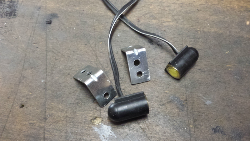

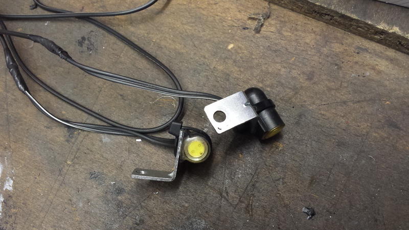

I chose to have the bullets on the Givi frame, there were pre-drilled holes in the right places.  I made small brackets out of Stainless steel.  If you do not have a Givi frame you could make a bracket and attach it to the hand rail. The Givi frame is made of mild steel, so drilling holes to suit is not a problem.  A good trick here is to put some masking tape onto the frame and mark the spot with a pencil.  Measure 3 times before drilling!
Center punch to ensure that the drill bit does not slip.

I threaded the cables through a heat shrink tube. Using a heat gun shrink the tubes very carefully. This is for added protection from the elements. Now thread the cables along the chosen route.
