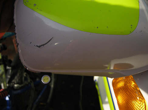

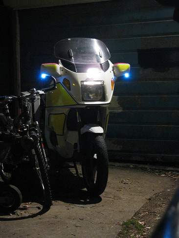

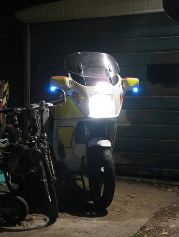

This K1100LT has Bullets out wide for a good profile.... and the paint work would have me shaking in fear if in mirrors :)

Oh and it's got the PODs fitted now, alternator output issues killed the Bullets as you know, thanks for sending the Pods last year.
Glad they still going strong Neil. My father has the same lights on his LT with no problems at all.
