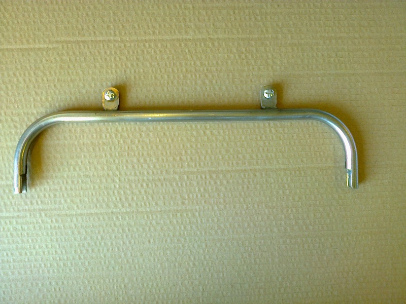

Bryan took time to send the following photos of his Honda Varadero with BikeVis Bullets installed. He took the time of making custom hangers to get the Bullets as wide as possible to great effect. As usual it's hard to capture just how bright they are with a camera...

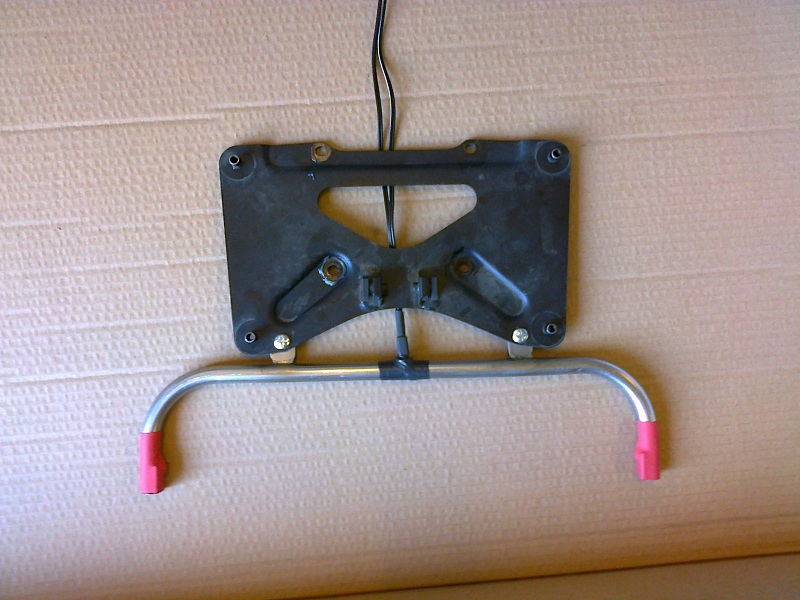

The Red bullits slide into the 1/2 SS tube that is rounded and fits onto top box rack. They are located by the heat shrink.

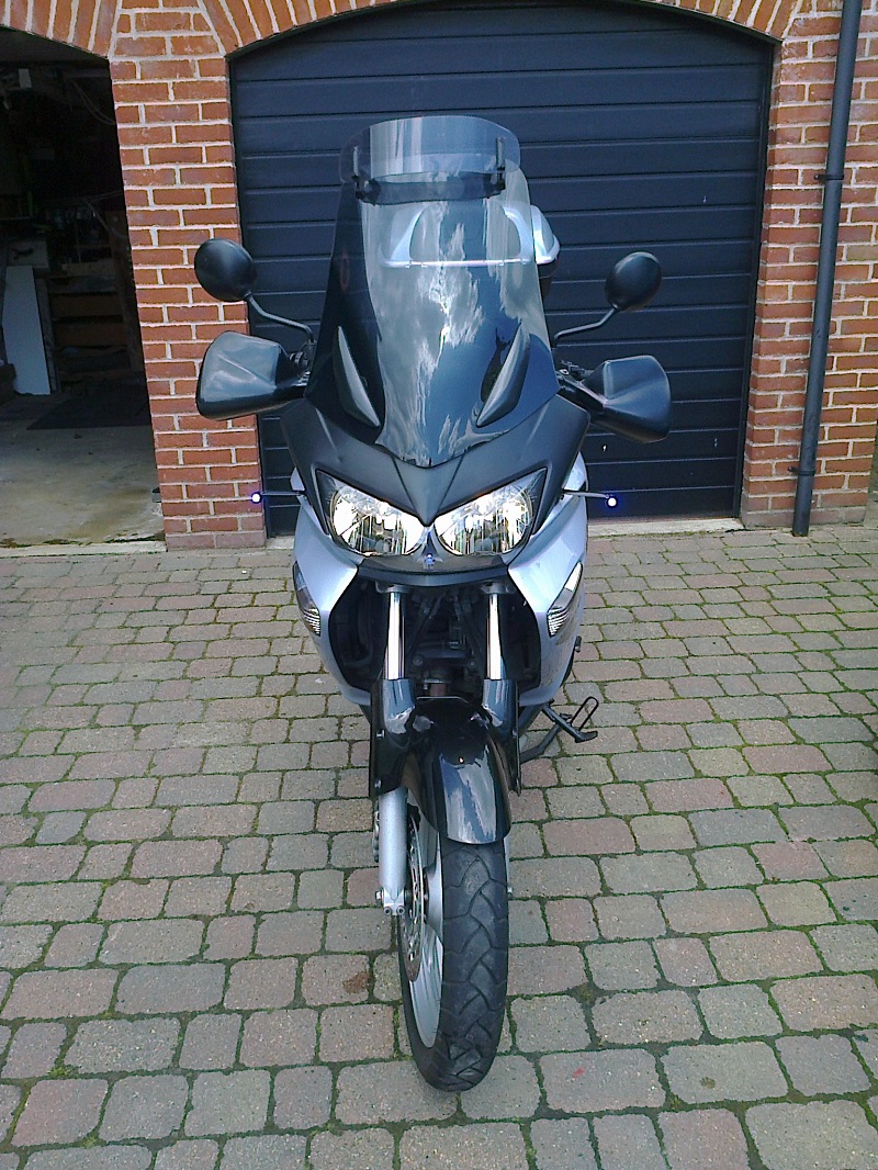

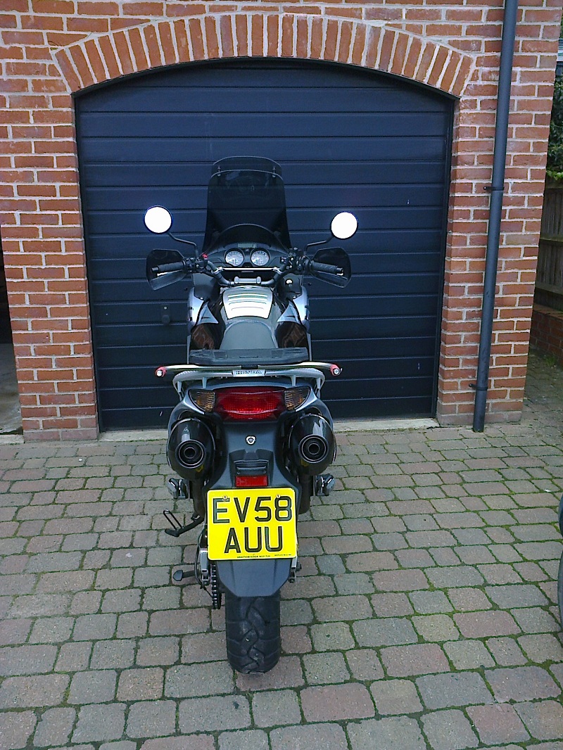

When on the bike Honda Varadero, they are about the width of the exhuasts, but fit nicely under the top box when fitted.
I use the bike all year and all weathers so trying to make the bike seem wider.
The rear lights are linked to your stop light unit so go brighter with the stop lights, by using a couple of diodes, they also flash with the indicators.

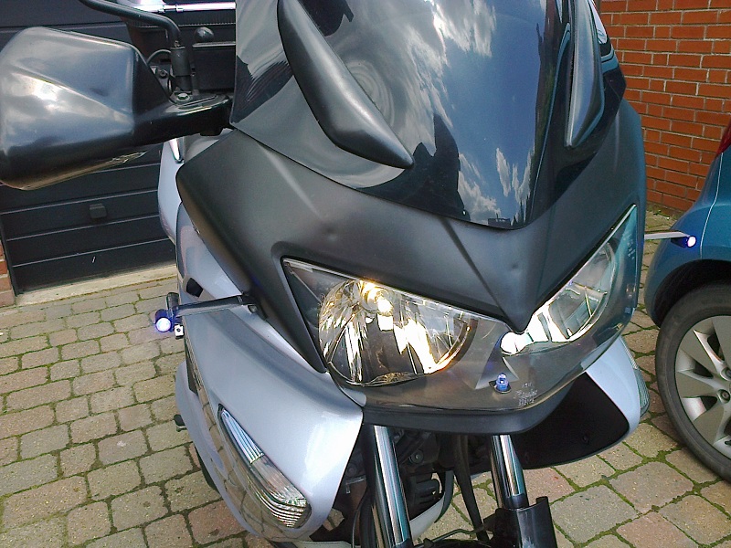

The front  LED's are mounted on aluminium section (slightly curved) which is nice and stable. sprayed black and mounted using the fairing bolts.
Normally front bullets are connected to "glimmer" module, but can be switched to a stop light unit like the back and both flash with indicators.
