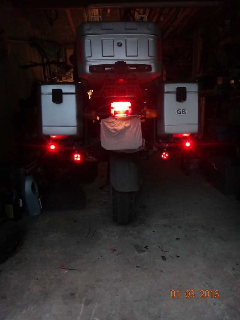

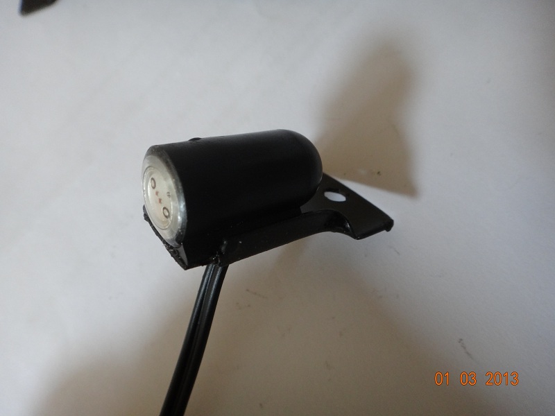

Cree v3 wide angles on a 2007 Versys.

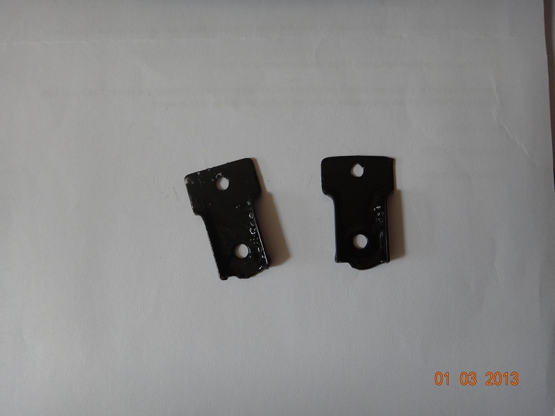

SWMotech 27mm brackets to fit the H&B crash bars
Took the brackets of the lights.  Attached them direct the the new brackets.  One nut needed a few mm taken of with a dremel
Bracket fitted on crash bar.  Few rubber shims around it and one when the light attaches incase it tries to move
Heat shrink on the loose wires of the loom to protect them and keep then neat
New switch on handlebars to be wired in
Lights and switch wired back through.  Few bits of trim removed, wires cable tied to main loom along side of tank
Little 4 way fuse box fitted.  Bit of, crimping and testing
All wired in of a relay
All looking good !
